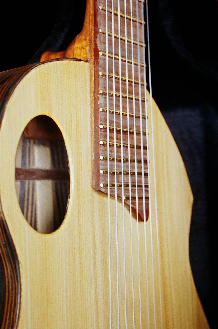

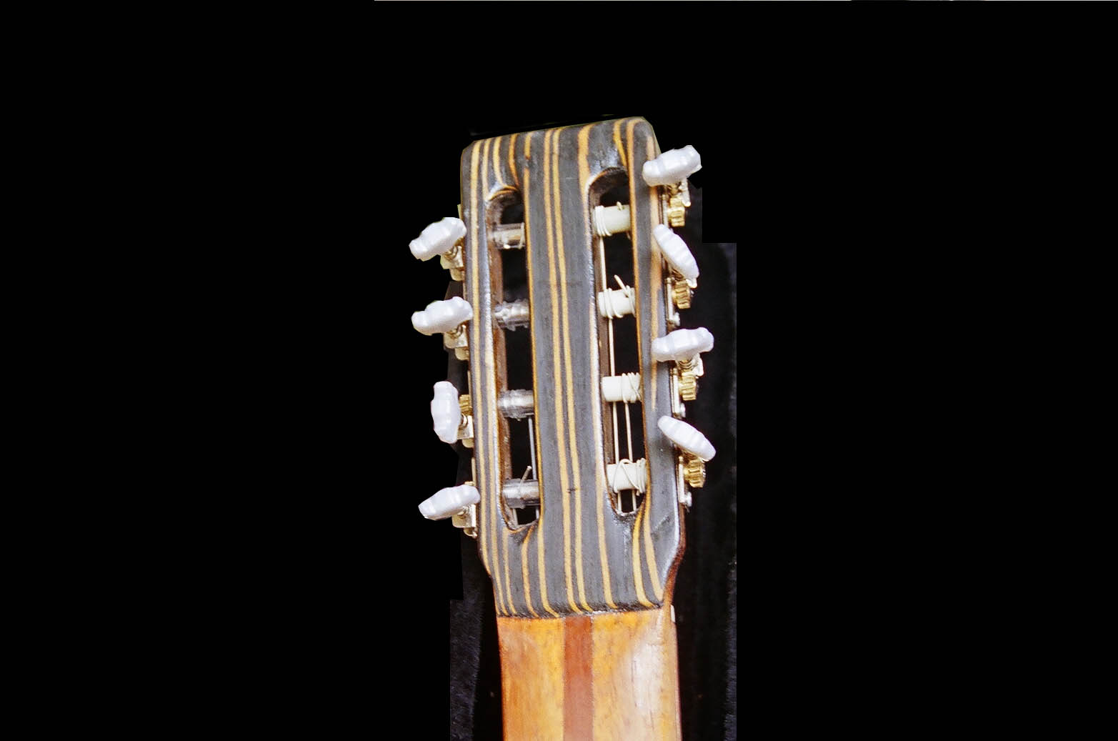

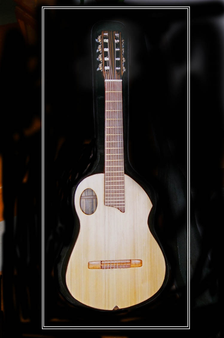

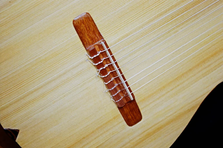

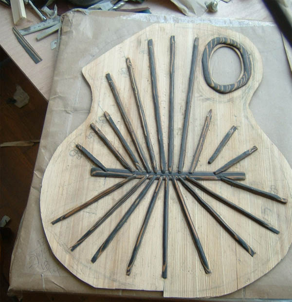

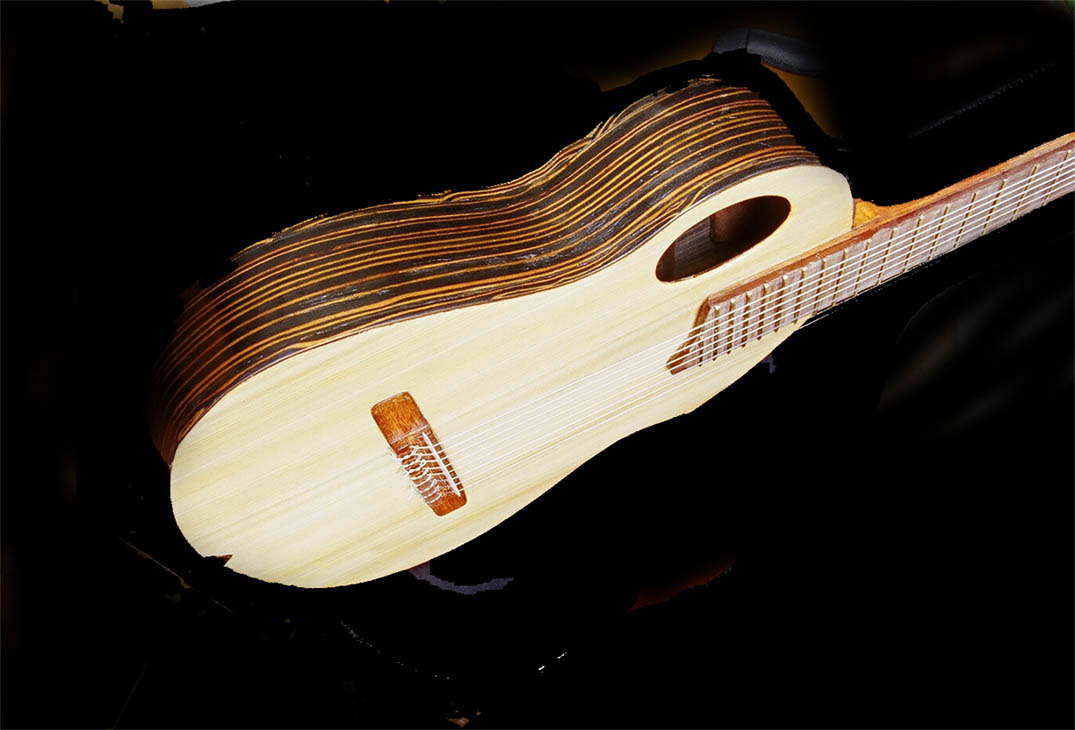

It's not asthetically perfect. there are lots of mistakes but it sounds great. The bass notes have an great sustain and tone. It's much better than the classical I play now. I am happy to play it.
specs
8 strings
top: 4 piece spruce
bracing: striped ebony
Back: 5 piece striped ebony from a wall molding
Neck: huang hua li (yellow rosewood) and ironwood center
Fret board: Ironwood
Bridge: Yellow rosewood
Bridge cap: ironwood
frets: brass welder's bar
nut and saddle: bone
finish: tung oil and wax

Hey Bill, I love that guitar!!! The shape is great, the back is beautifull and the top has a ton of character, I just wish those cool braces could be on the outside so they could be seen. That striped ebony is about the best I've seen, it is very bold and you've really done it justice. It looks great with the binding of the same as well. Keep it up and show us some more.
